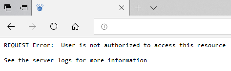

When setting up PAW to allow for user imports (ENABLE_USER_IMPORT = false configuration setting) the message a user that tries to log on to Planning Analytics license without being set up as a PAW user is not user friendly and looks very much like a technical server error.
The user we have tried with has access to the underlying TM1 instances but is not set up as a user in PAW. The user can log on to Arcitecht, pmpsvc and tm1-web without any issues.
When this user tries to log on to PAW an error is shown, see attached screen dumps. We understand that this is the intended behavior – the user should not be allowed to use PAW as he is not pre-defined as a user in PAW – but the message shown is not user friendly and do not give any hint on how the user could resolve the access issue.
Workaround:
There is no workaround at this point (confirmed by IBM Support), users will have to report an error, not always understanding that they should apply for access.
